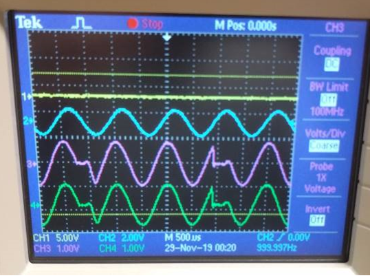

Now I also implemented the float32_t FIR example from CMSIS/DSP. I have verified, that the FIR filter works (amplitude shows low-pass characteristic). However I am seeing (and hearing) that the audio signal has gaps.
(blue: Input, 1Vpp, 1kHz. green/pink: Line Out L/R)
I suspect that this happens because I execute the FIR filter inside the DMA ISR - which is not the way to do it. The next step is to implement a buffering method to run the FIR-Filter not FFT (as in the comments) n the main loop.

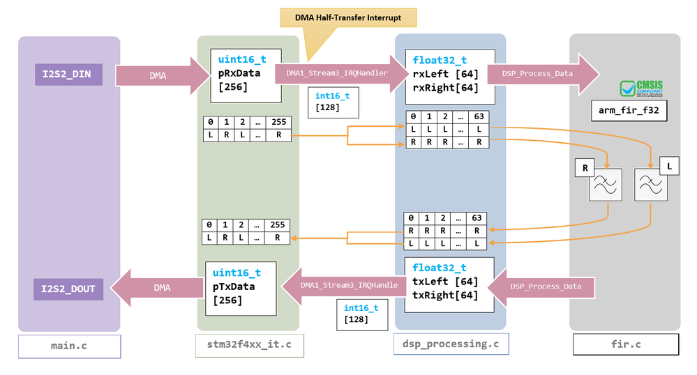

I was now able to implement the DMA Buffer with an interrupt on half-full. Another issues was in how I implemented the FIR filter with the wrong parameters.
The DSP routine (including the FIR) is still called in the ISR as the processing time is much less than the buffer length times sampling period.
DMA runns on the pRxData[2 * DSP_BUFFERSIZE] and pTxData[2 * DSP_BUFFERSIZE]

DMA Half-Transfer Interrupt was what I needed. Thank you for pointing this out.
