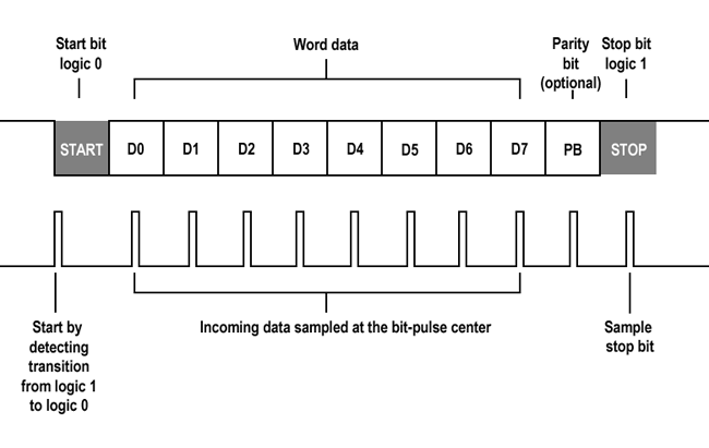

2022-06-15 10:45 AM
The parity is the last bit sent, followed by the STOP bits, which provided for an intersymbol gap
In STM32 peripherals, the parity is counted as a bit, so 8E1 would be 9-Bit Including Parity
Line normally HIGH
START BIT (LOW)
BIT 0
BIT 1
BIT 2
BIT 3
BIT 4
BIT 5
BIT 6
BIT 7
PARITY BIT (making HIGH bit counts in total ODD or EVEN)
STOP BIT(S) (HIGH)
Line Continues Normally High, or you see the NEXT Start Bit

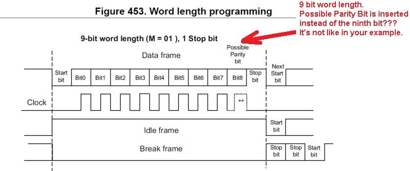

2022-06-15 11:00 AM
Ok. Understood. It seemed to me earlier that the parity bit is part of the 8 bits of data that are transmitted.
2022-06-15 11:23 AM
>>..is part of the 8 bits of data that are transmitted
Well in ST's case if you set 8-bit mode and even parity, everyone else would call that 7E1
ST generates the parity bit on transmission.
On reception you need to strip it from the UART->DR / RDR with a mask, as the 16-bit register will have the parity bit present. If you cast it into an uint8_t it will obviously be lost, in the 8E1/8O1 cases, but just keep it in mind if you carry it with a 16 or 32-bit variable.

2022-06-16 4:27 AM
This picture contradicts what you wrote, as it seems to me.
Here the Possible Parity Bit is inserted in place of the ninth bit of the transmitted data?
In your example, the Possible Parity Bit is inserted AFTER the ninth bit of the transmitted data.
8E2sBBBBBBBBPSS
I took 8 bit mods as an example. In your example, there was no 9 bit mod.
