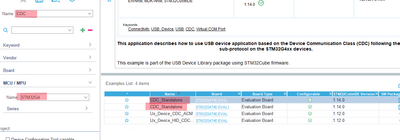

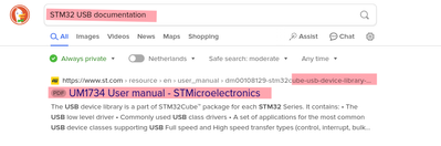

And did you look for examples?
> let alone documentation for the USB code.
And did you look for documentation?
As far as getting the device to simply enumerate, there's no real need for an example. You just configure the USB peripheral as a CDC device in Cube and generate the code. On the software side of things, nothing more is required for the board to show up as a COM Port in windows device manager.

2024-07-31 9:43 PM - edited 2024-08-08 2:46 AM
@KHarb.1 wrote:
Debug: I don't have a good example for the G4,
