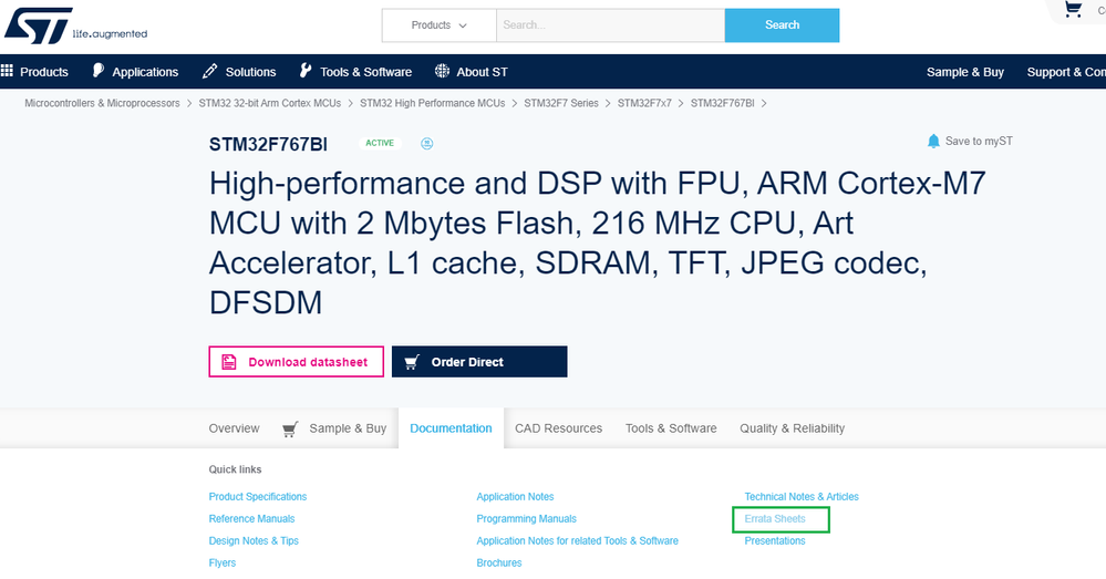

Hi @NJENN.1 ,
Here is the Errata sheet applies to the part numbers of STM32F76xxx and STM32F77xxx devices: ES0334 STM32F76xxx and STM32F77xxx device limitations 6.0
You will find all resources related to your device in the product page, in the Documentation panel:
