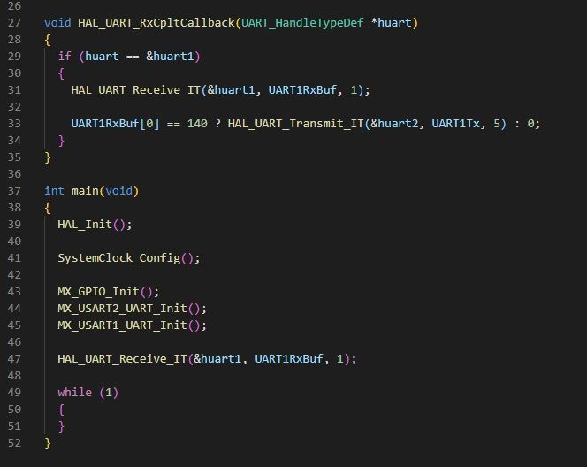

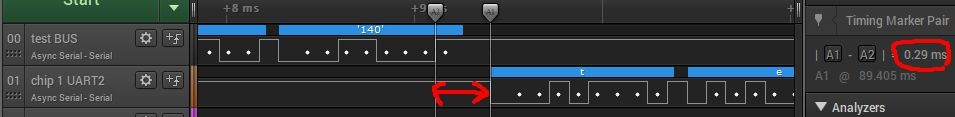

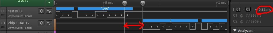

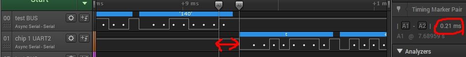

I'm writing a throw-catch case of 2 chips, the Host throws an message onto UART1 bus, then the Slave catches and shows message on UART2 for debugging, there are a delay between catch and throw, but the delay time is not always the same, in my opinion the delay time should all be the same or has just a small difference such as 5 micro seconds, however the delay time may be from 210us to 320us, the difference is 110 micro seconds, how can i reduce this differ?

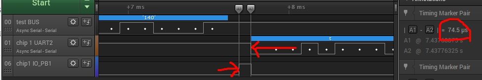

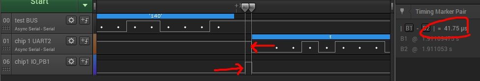

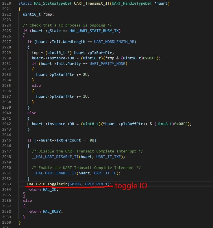

The process of HAL uart is HAL_UART_Transmit_IT -> USART2_IRQHandler -> HAL_UART_IRQHandler -> UART_Transmit_IT
I toggled an IO pin inside the UART_Transmit_IT after the DR is writen, it shows that the time jitters is not caused by the process of HAL
and i also set uart2 interrupt as the highest priority, but there is still no any clue on jitters
