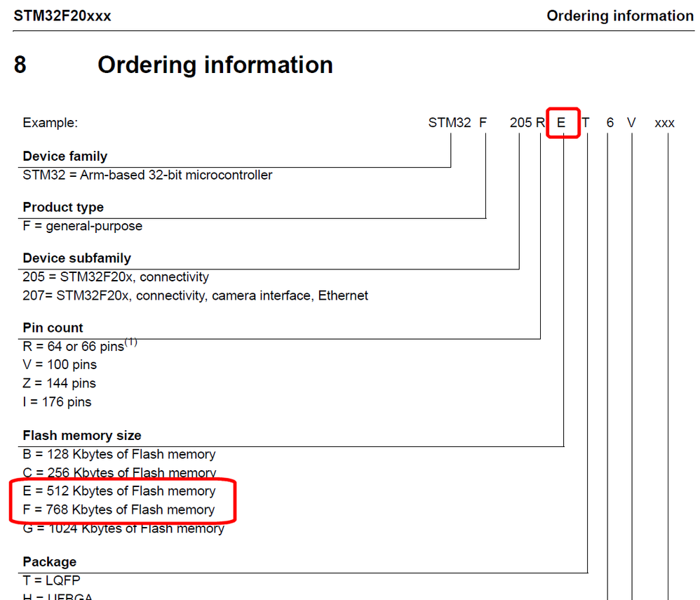

Or are you just asking what's the difference between STM32F205RFT6 and STM32F205RET6 ?
The answer to that is in the datasheet:
