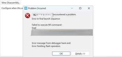

I am getting a warning "The core is locked up" and a few more (please refer to the attached image).
I have also tried flashing with the hex file, but some flashing issue is observed.

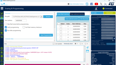

I had the same error and the issue was the "Start Address" value was wrong.
I had accidentally selected the wrong file+filetype (.hex instead of .bin) and it erased my start address (and disabled the field). I had to select the correct file (the .bin file), then I tried filling the Start Address back in by typing
0x08
But that wasn't good enough. I had to fully type out
0x08000000
And then it worked correctly and I stopped getting the "Core is locked up" error.
From your screenshot, it looks like you may have the same issue (wrong Start Address).
