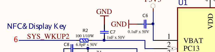

Hello, i'm working with stm32l412cb on custom PCB, and I ran into trouble.
Is there any way to wake up MCU from standby by falling edge?
Here is scheme and code:

2020-07-29 4:00 AM
Found a solution, if anyone is interested.
WKUP line is also controlled by a EXTI line, so, you should use these pins as EXTI with falling edge interrupt, and enable them as WKUP source.
2020-07-29 4:00 AM
2020-07-29 4:14 AM
I mean you miss and in pdf a WKUP pin event (configurable rising or falling edge)
EXTI work with SLEEP and STOP , but i not expert for cortex4
