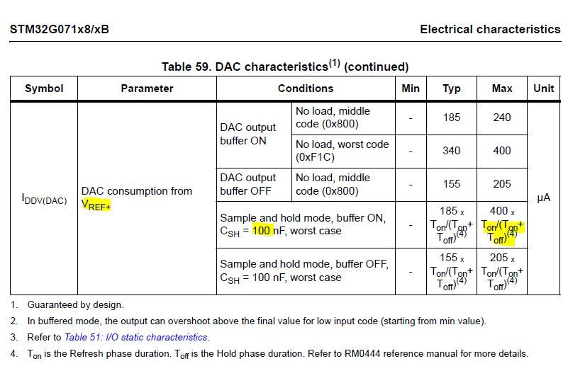

can you provide a schematic? which device are you refer? Note that VDDA must be >= vref.
VREFBUF also must be disabled to provide external voltage reference.
Vref consumption depends also from load capacitance connected to output.(dynamic condition)
In some devices is possible the internal PU/PD resistors to be connected to pin , independently from DAC config.
Make sure that DAC output pin is set to analog mode before DAC is enabled.
Consumption also depend from DAC output buffer state. (Buffer acts like Op-Amp configured as voltage follower).
Try to disconnect external opamp to isolate the problem of increased consumption.

ADC loads VREF+ too.
Try a simplified program which does nothing but set the DAC once and then goes to loop.
Observe VREF+ using oscilloscope. I suspect the consumption from it is pulsed; try filtering.

What capacitance do you have on the VREF+ against VSSA?
> although the 3.3V isn't a signal with high frequency
How do you know? Did you observe it using oscilloscope (and appropriate probing - we're talking millivolts and hundreds of MHz)?
As I've said, the VREF+ consumption is probably heavily pulsed.
