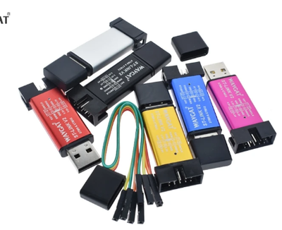

Are you using a genuine ST-Link?
ie, not something like this:
