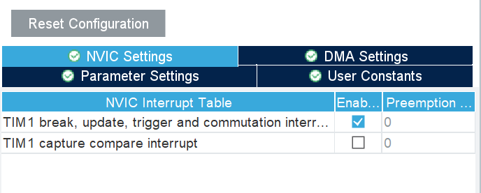

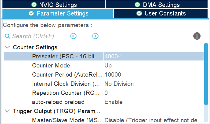

I have STM32G070RBT6, a timer is set to give interrupt every 1 second, in interrupt i am incrementing a variable timer_var1 then in main file while loop i am dividing this by 10 and assigning this value to another variable TIMER_NOW.
Now when timer_var1 hits value 389(decimal) it rolls over to 255(dec).
there is nothing else in the while loop.
i am not able to figure out how is it possible.
