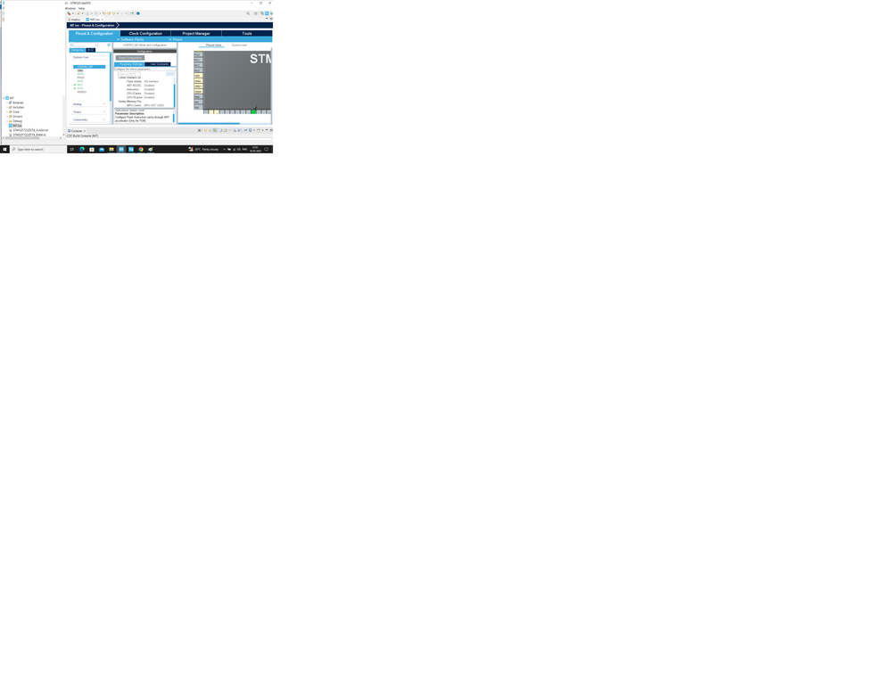

}the above code of standby activation and wakup from pin PA0 is working with stm32f103 series and stm32f411 series but not working with stm32f7222ze Nucleo board .

stm32f7222ze first time going to standby mode and once you give the wake up then it's keep on going to initializing and and waking up automatically . any one please suggest me about stm32f7222ze nucleo board stand by activation and wakeup
