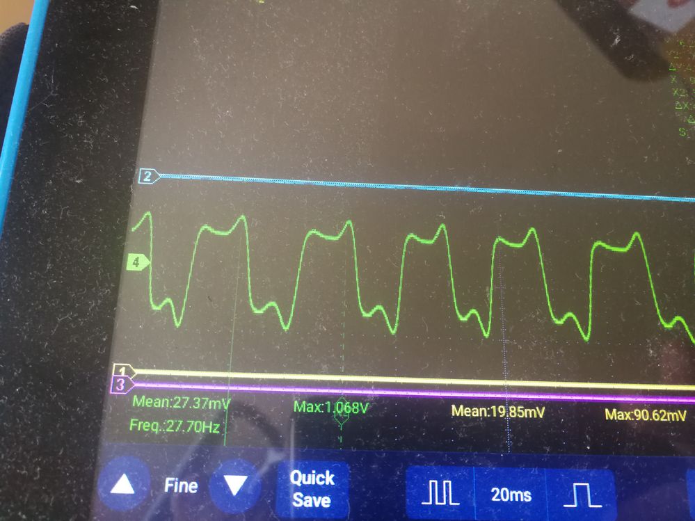

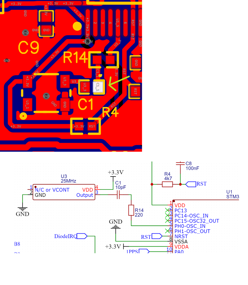

I would like to use TCXO (25 MHz) for timing STM32L071. It doesn't really work for me. When I put a scope probe behind C1, a signal can be seen in the picture. (some 27 Hz). Do you know what's wrong? The power supply for TCXO is 3.3
Please any idea? Thank you.

Check if you are not looking at "aliasing"

HEY you are right!! That's surprising! I'm currently observing a 25 MHz signal with about 2 Vpp between C and R.
Just can not see MCO outpu on PA8... Set in CubeMx..

By the way, what is purpose of C1 and R14 and how do you control DC voltage at PH0 input ?

So you think C1 and R14 are not necessary and I can connect it directly? (I came from some STM32 wiring where I saw C and R.)
2024-03-31 1:21 PM
More than unnecessary. I think that its wrong.
