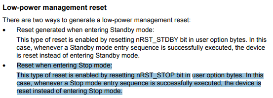

jdumaresq
Associate II
Just to add that if I use HAL_PWR_EnterSLEEPMode instead of HAL_PWR_EnterSTOPMode
The code work as expected.
From my debugging, the board reset when calling the HAL_PWR_EnterSTOPMode
jdumaresq
Associate II
Just found the answer....
