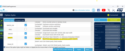

Hello @EliazLB;

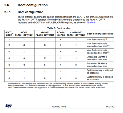

According t the BOOT_LOCK, nBOOT1, nBOOT0, BOOT0 nSWBOOT0 configurations, the MCU operates on the main Flash memory, boot from system memory...
For the STM32G474, the bootloader is activated by applying Pattern 14.
You can used the STM32CubeProgrammer to configure the option byte like as nBOOT0, nSWBOOT0 and nBOOT1.

Simply new MCU use automatic line 3 in pattern table. After first programm loaded (any way) only lines 1,2 work. Basic factory config is for line 1. Set boot pin high externaly and reset or power on. Open programmer select COM when USART is used and click connect.
2025-04-18 5:24 AM
Fy,
To tell an MCU you have to start with the boot loader, this one must be configured as following AN2606 and pattern 14 in your case. From an hardware point of view the selection with pattern 14 allows 2 cases where Boot0 (pin) must be tied to 1 ( Vcc. 0 being ground).
Assuming this fact the MCU starts directly under bootloader mode (with two cases; one bank or double bank organisation).
