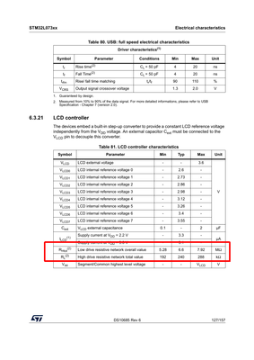

Also, I couldn't find the RL and RH values in the datasheet. Is it possible to have it, plase ?

Thank you for the screenshot of RL and RH.
