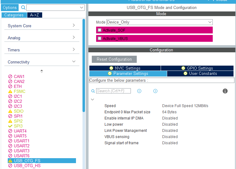

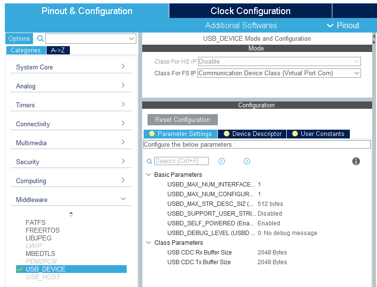

2019-03-29 2:40 AM
I have the same problem like you @med zarat ''This device cannot start(code 10)''.
Magically that when I change Heap Size from 0x200 to 0x1000 and Stack Size from 0x400 to 0x500, it will work.
I can see that both your Heap Size and Stack Size are 0x1000, but I do not why it is sill in that problem.
I think this is the problem related to memory.
Maybe you can change the buffer size of the USB?
This is my setting in STCube. Hope that it will be usefull.
