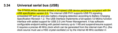

I am currently working with the STM32L433RC microcontroller and I am exploring the possibility of utilizing USB 2.0 in Host mode for my application. I am seeking guidance on the respective topic.

The STM32L433RC MCU support only Universal serial bus full-speed device interface.
Please refer to RM0394 section 45 Universal serial bus full-speed device interface (USB) and the datasheet.
The STM32L433 MCUs doesn't support the USB HOST mode.
Note that the STM32L4x5/L4x6 devices support USB HOST mode (RM0351)
