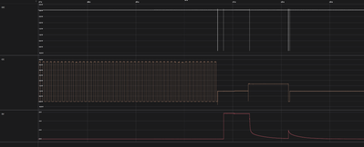

Here are the waveforms for I2C Comms to the TCCP Chip, CC Line of USB C Connector and the 5V Rail after the switch of the TCCP:
Here are the waveforms for CC Communication:
Here is the output of the trace:
