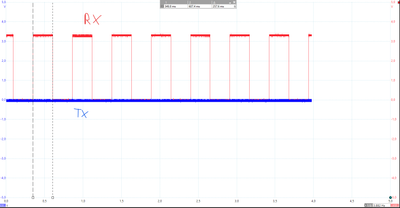

Hello everyone,
I successfully used USART1 and USART3 in my application. However, when trying to use USART4, Rx is working but not Tx. The idle signal stays at 0V all the time.

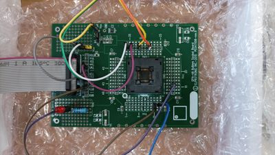

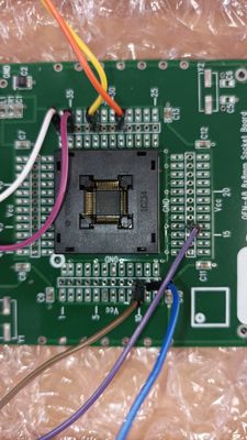

To try with a minimal hardware configuration, I used the following socket : PE047X06.
For the program, I used a minimal one straight out from CubeMX with only :

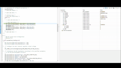

In debugger, stop the program and check/post content of GPIOA registers.
You can also try toggling directly in debugger.
PS. Connect VBAT to VDD and make sure it powers completely down to 0V before starting again, because of the "backup domain brownout" erratum. You can try to perform the backup domain reset in software, too.
Here is a video of the GPIOA registers during SET or RESET :
As you can see, ODR is set to 3 in SET state and to 0 in RESET state which seems normal.

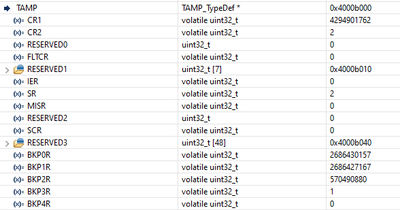

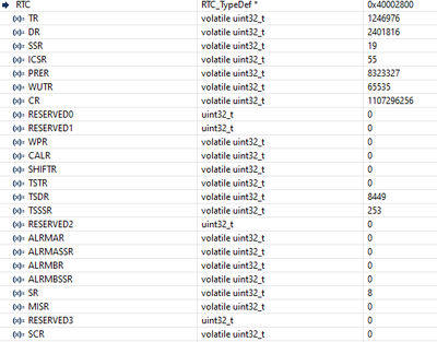

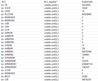

Here are RTC, RCC and TAMP registers.
RTC
RCC
TAMP
I tried to reset backup domain on my Nucleo-G070RB with minimalist code by setting RCC->BDCR->BDRST to 1. It worked, I was able to control PA0. However, when doing the same thing at the beggining of my application, it doesn't work.
By looking at the registers, do you know why I can't control PA0. Does it have something to do with RTC_TAMP_IN2 ?
In TAMP register, CR1 is showing TAMP2E enable.
