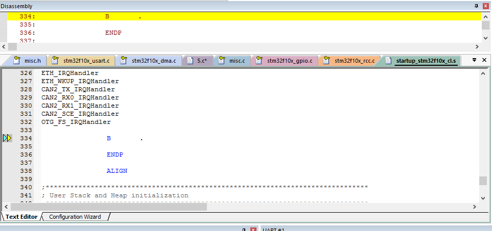

I configure USART1 and enable DMA interrupts but it doesn't do any reaction to receiving data. what is my mistake?

You are only configuring the USAR1 Tx DMA channel (DMA1_Channel4). You should configure the RX channel for receiving data (DMA1_Channel5). As a help, See code in this user [DEAD LINK /public/STe2ecommunities/mcu/Lists/STM32Discovery/Flat.aspx?RootFolder=/public/STe2ecommunities/mcu/Lists/STM32Discovery/UART%20with%20DMA%20mode&FolderCTID=0x01200200770978C69A1141439FE559EB459D75800084C20D8867EAD444A5987D47BE638E0F¤tviews=21897]thread -Hannibal-2016-09-08 11:44 AM
2016-09-09 12:28 AM
DMA1_Channel5_IRQHandler()
i.e. remove ''n''
2016-09-09 10:36 AM
Thank you waclawek.jan
It works fine. How can change the address pointer to the first address of input buffer variable?before it causes an interrupt or getting fullWe’re moving the ST Community to a new platform to give you a better and more reliable community experience.
