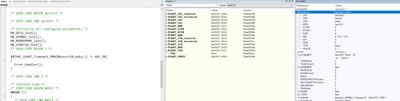

2023-10-06 6:28 AM
Does a blocking HAL_UART_Transmit call work?
You could look at the state of the DMA for error flags after the TC interrupt fails to happen.
