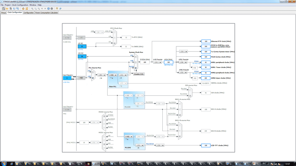

I would like to
know how I can
write the value
9600 baud or 2400 baud directlyin the registry
I found
USART1-
BRR
but when I put the frequency / 9600, it does not work :/, my frequencey it's 180Mhz. Thanks you :)
2016-09-15 9:32 AM
You'd have to divide into the APB clock for the USART, in this case APB2 at 90 MHz, and the value would need to fit in 16-bit
For the 16x over-sampling case 9600 BRR =9375 2400 BRR=375002016-09-19 1:27 AM
