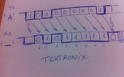

2013-04-04 3:23 PM
''i will see in the oscilloscope, i will upload a image with the results''
Do take time to think about what you see before uploading it''When I send 'U' I receive 'U' in tera term, but when I send 'A', I receive '_' in tera term, For 'B' sent, i receive '/', etc...''
To say ''etc'' implies that there is a regular pattern - so think about what that pattern could be; and think about what might cause it...Hint: Draw the waveform for the ''sent'' character, and the waveform for the ''received'' character - and compare them... The most important tool for debugging is the one between your ears...
2013-04-05 2:48 AM
Thanks a lot mate! As you just said, I realised what the error is.
Will try using a TTL Usart USB device.This is my oscilloscope's capture:2013-04-05 4:11 AM
Use a proper level convertor (MAX3232 and similar).

Thanks a lot! Trying with a TTL USB this evening.
SOLVED.2013-04-05 2:09 PM
