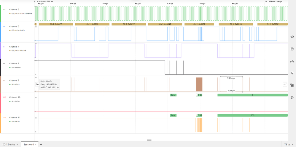

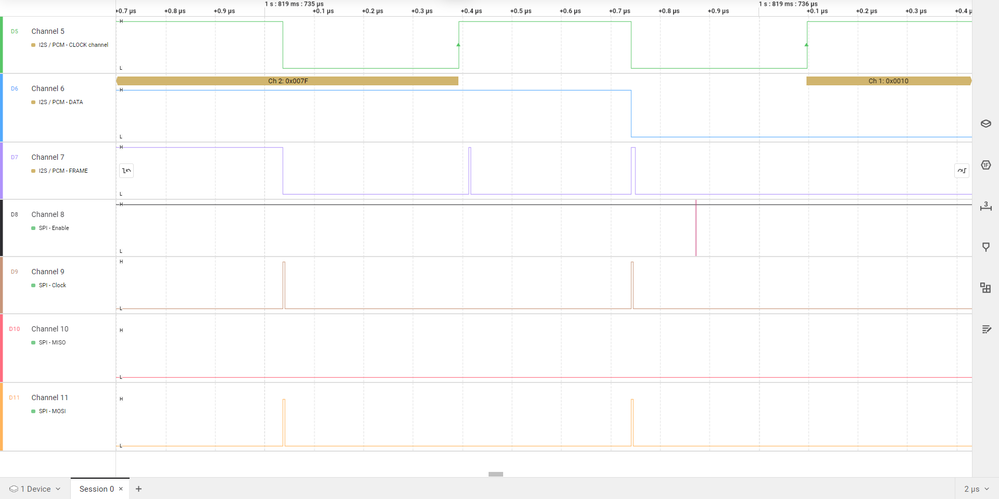

I confronts a very interesting problem at my project. Details above:
Hardware: NUCLEOG071RB
Attached the IOC configuration. Control the SPI CS pin by software. I got small 4-8us signal spikes all GPIO, SPI, I2S pins. SPI and I2S powered by DMA.
I tried connect serially 33K resistor with less success. The 3.3V power line is stable. Jumper wire length 10 cm.
Any idea what I did wrong?
2025-02-23 2:53 AM
How about your ground connections ? (spikes on all lines = typical for bad/long/indirect ground connection)
2025-02-23 7:35 AM
Looks like all glitches are positive-going pulses. Is your logic level set to 3.3 V and not 1.65 V? You can filter out glitches on each channel.
