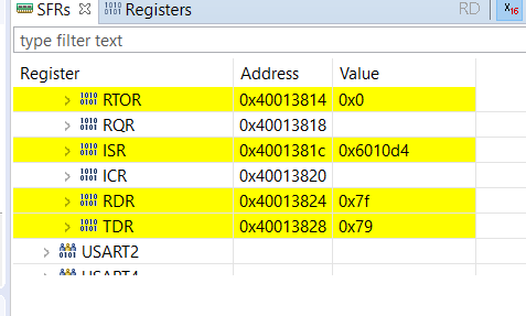

and after entering into the bootloader, we can see 0x7f and 0x79 value in RDR and TDR registers of USART as shown below as per the bootloader requirement for USART.

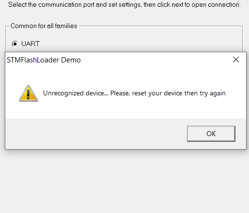

But still on STM32Flash loader the device says it is unrecognizable as shown below.
Here is the STMflash loader settings.
Still I'm unsure why the software is not recognizing the STM32 MCU. It would be great help from your end if someone help me in fixing the issue.
Old Software
For the L0 you likely need to be using STM32 Cube Programmer in UART mode.

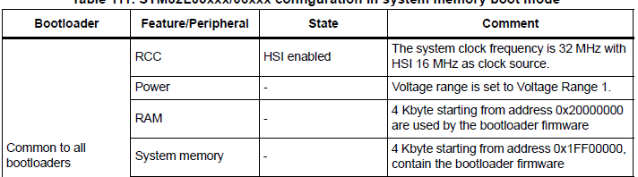

This is the system memory of the L0. It is 0x1FF00000. Do I need to add any extra offset for this?

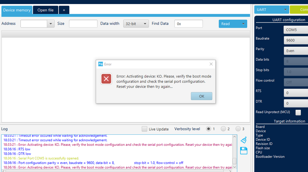

Also I tried using STM32 Cube programmer. I'm getting this error.
