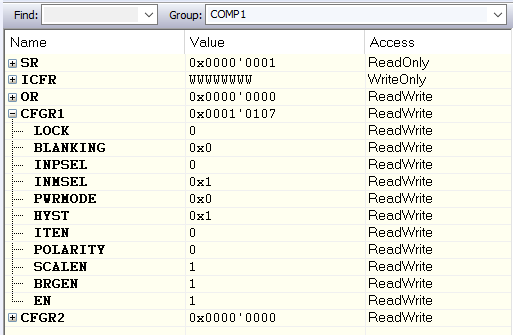

With debugger I do see BRGEN and SCALEN bits enabled. But it just does not act as it suppose to. What do I am missing. is Vrefint needs to be enabled? I was unable to find this information... Also I am using LL libs.

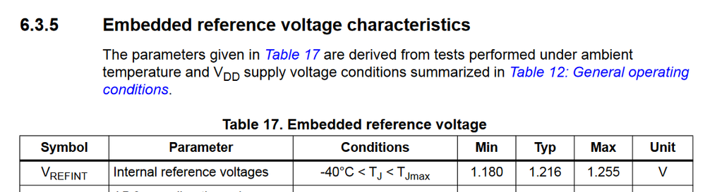

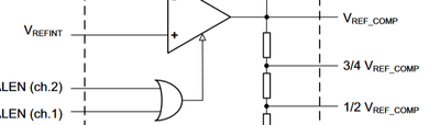

Created a ticket for STM32 engineers and they finally provided clarity on this matter. As it turns out, it uses completely different REF, and it is independent of VREFBUF and external reference. It is an integrated 1.2V reference that could not be changed. This explains why I could not change the voltage level for the comparator. So maximum voltage is indeed 1.2V for this setup.
Only way I can fix this is by adding a resistor divider, where there is no option to do it in the MCU itself

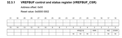

LL_APB4_GRP1_EnableClock(LL_APB4_GRP1_PERIPH_VREF);
VREFBUF->CSR= 2;2023-12-31 7:05 AM

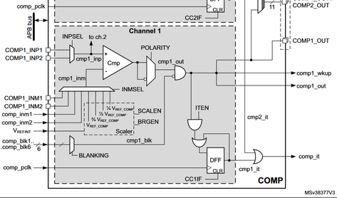

>RM is so ambiguous about this VREFINT signal....

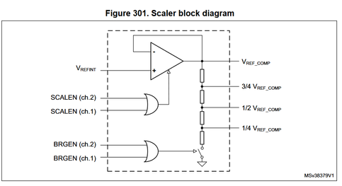

I dont think so, its obvious to see: VREFINT is the "master" input signal for all other , parts of this VREFINT :
+ enable it ? If you expect it working, enable might be a good way...

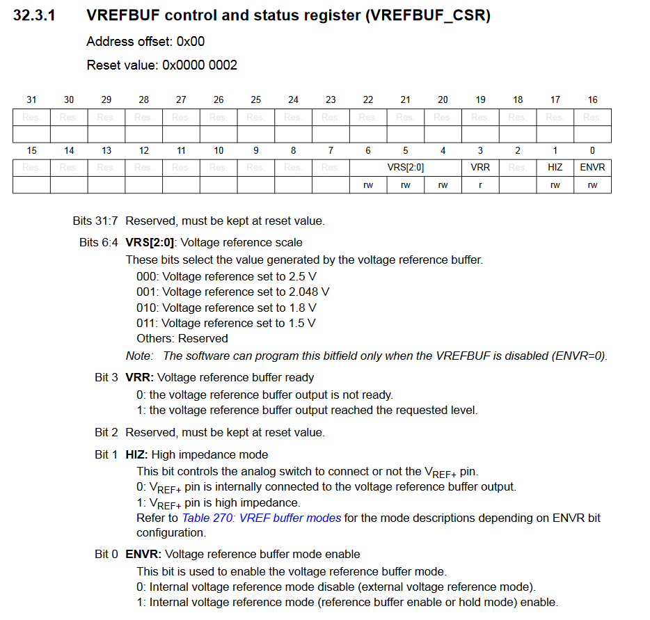

Enable ENVR , set VRS[2:0] (to 1,5V = 011 ) - test and tell...

tested all combinations inside COMP1 and VREFBUF , none of them are working as expected. At this point it looks like error in RM or silicon ? (have 7 boards with same problem, will test it on NUCLEO development board soon) ( i know, it is far fetched. It is always my fault in past experience, just question where...)

And now I was able to test threshold, and is exactly at 1.2V (with COMP_INPUT_MINUS_VREFINT setting). This is why half of my boards are failing or are unstable when VREF is selected, it is so close to that trigger value. And adding hysteresis makes it unresponsive at this setting. So I am at the loss here, whats wrong...
Selecting COMP_INPUT_MINUS_1_2VREFINT I get trigger point of 0.6V. This explains why my setup does not work, my offset is exact of this virtual level of 1.2V (this is coincidence, it's is a LVDS muxer chip TH level generator )
So comparator is working, but Vrefint is at 1.2V? This is not possible by any setting even if I try....

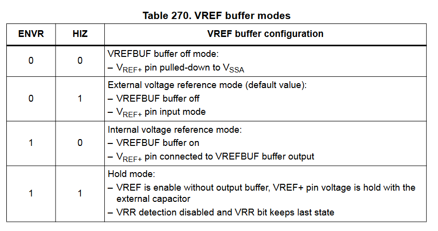

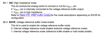

Ok, then you set : vrefbuf pin input mode (HIZ + ENVR 00)
try...

With debugger, I tried all combinations of registers on REFBUS and COMP, with no effect... Note I have reference driving REF+ pin.
