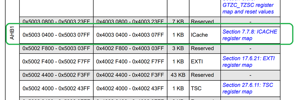

Here are the ICACHE register map for the configuration and status bits
