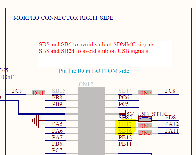

Are you accessing them on CN12? Did you close SB16/SB17? The user manual could be more clear about this, but it does mention them.
2021-08-12 6:53 AM
Okay, found the problem. SB16 and 17 were not assembled on the Nucleo board. This disconnects the morpho connector from the MCUs IO-pins.
