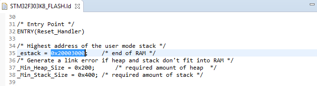

2018-03-23 6:25 AM
Hallo,
I just solved the problem.
The cause was the wrong linker file.
In the file generated by TrueSTUDIO for STM32F303K8, the stack was allocated to a reserved memory area (0x20004000).
With the stack correctly located at 0x20003000 (as from the data sheet of the MCU), everything works correctly.
I reported the problem in the forum discussion titled 'Stack lenght wrong in Atollic linker file'.Here you can find both the files: the wrong and the right.
Thanks for your interest.
Best Regards,
Giampaolo

_Min_Heap_Size = 0; /* required amount of heap */_Min_Stack_Size = 0x80; /* required amount of stack */2018-03-26 8:45 AM
Hello
pantaleoni.gp
,After check my project withSTM32Cube_FW_F3_V1.9.0 and TrueSTUDIO
V 9.0.0, I have in the linker file the End of RAM at
0x20003000.
Please check if you
are using an old version of Cube package that need update.
Best Regards,
Imen
