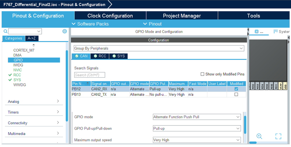

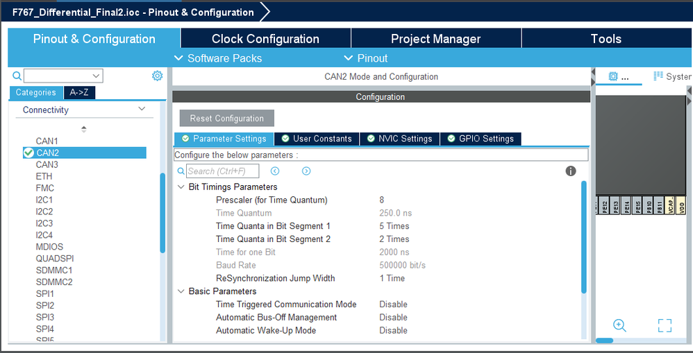

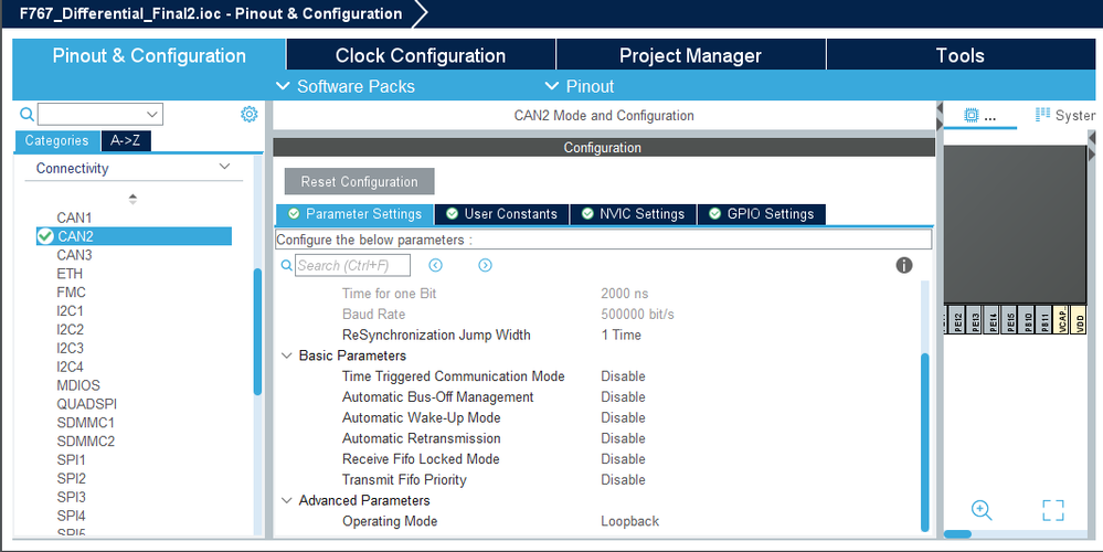

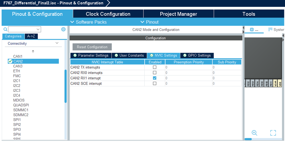

2024-07-05 10:05 PM
Here are some pictures of IOC file configuration for CAN:
