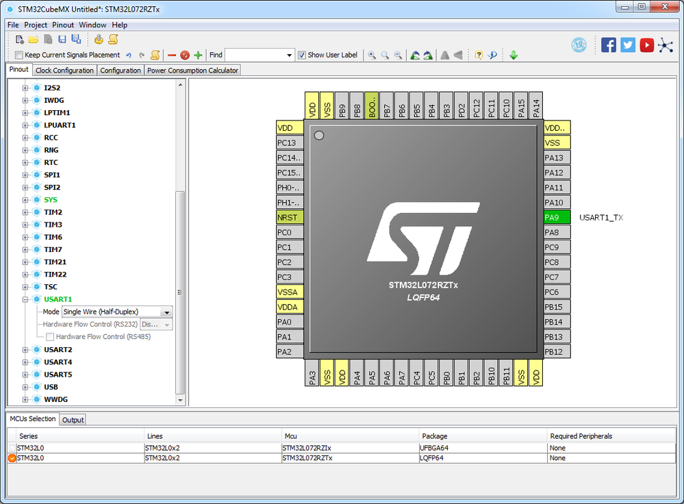

Hello Lukas,
On of USART modes is called Single Wire (Half Duplex). This mode uses single pin for USART and by using this pin USART is able to both transmit and receive. But as far as I know in all cases USART TX pin is used for this mode, so you would be able to use USART RX pin for different purpose.
USART Single Wire (Half Duplex) mode can be configured in Pinout tab of STM32CubeMX. Please see below the picture, which shows an example.
Regards
