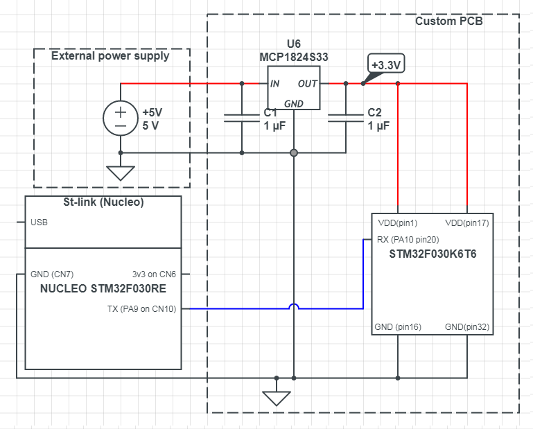

Hello, I am trying to make communicate a NUCLEO STM3F030 with a STM32F030K6T6 mounted on a custom pcb.
Tx sends from NUCLEO is ok when i check it on an oscilloscope but when i connect the power supply of my pcb on the NUCLEO (or even on an external power supply), the TX low state level is shifted from 0 to 600mV without understanding why. Here are my connections:
Note: i observe directly at the oscilloscope the Tx signal and the GND discussed above.
Did i do something wrong or missing anyconfiguration?
Thank you in advance,

2020-05-29 11:27 AM
I don't understand. Can you please make a drawing/simple sketch, or maybe even a photo of your setup, showing us the connections, and where the problem exactly happens?
Can't the problem be related to connection to the STLink's pins for VCP on the Nucleo?
2020-05-29 8:04 PM
Pin PA9 being used on the Nucleo board?
Might be a diode being used as a level shifter, so the line stays one diode drop above 0V. Surely there's something on that line to explain it.
You drop the 5V down to 3.3V to run the device right?
2020-06-02 12:55 AM
Thanks a lot for your answers.
waclawek.jan, you ll find below a simplified sketch to get you better understand the connections of my circuit.
TDK, this is the software tool (STM32cubeMX) who has selected by default the TX and RX lane of the STM32 uart of the NUCLEO pcb).
For more explanation, when i send things on the TX lanes, the levels (high level is 3v3 et low level is 0) are good but, when i turn on the external 5v power supply, only the low level is shifted up to 0.6V, the high level state remains good.
I agree that there might be a diode issue (600mv corresponding to a average forward diode voltage).
2020-06-02 12:57 AM
Note: when i use RX (and also TX) lane of the STM32F030 mounted on my custom pcb to communicate with a computer (via an external RS232 converter), there is no issue of levels so i guess the issue is coming from the NUCLEO board.
2020-06-02 3:45 AM
Do you have a good and solid ground connection between the two boards?
Do you have a pullup set for PA10 in STM32F030K6 on the custom board? If yes, is there any change if you switch it off?
Is PA9 on the Nucleo board disconnected from the STlink on Nucleo (VCP solder bridges, see Nucleo manual)?
2020-06-02 4:13 AM
ok, it now works well. Indeed TX were connected to tx... my bad ! :D
