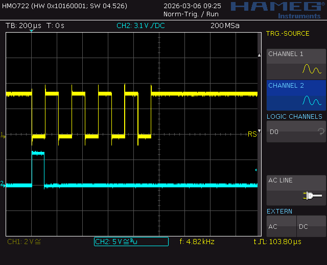

I understand. The time between when you send data to UARTx->DR and the time the TX line goes low (beginning of the START bit) has a jitter of 1 bit period. At 9600 baud, this is 105 us, which is what you see. There's no way around this.
One time the delay can be 5 us, the next it can be 105 us.

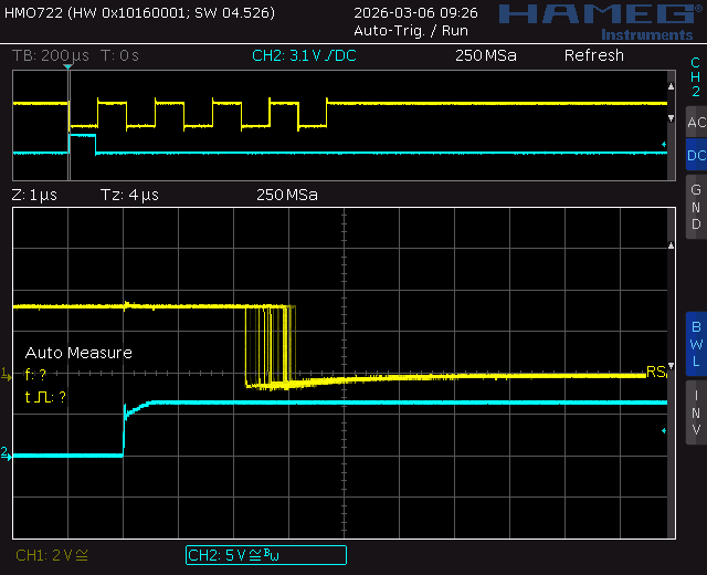

I took an STM32F042K (Nucleo), clocked it at 48MHz, ran a simple program that waits for a rising edge on PB3, and as soon as it arrives, it sends 1 byte via UART (baud rate 9600). The delay of 2-3us corresponds to what would be expected with this method.

What he describes is not software jitter. It is a feature of the UART on the F4. I decided to test it myself, and it is true—there is a 1-bit jitter (so it depends on the baud rate). The datasheet does not discuss this in detail.

Picked a NUCLEO-H533RE, used the user button callback to send a single byte via UART4 and it's working just fine. The byte is being sent consistently 4.4us after the GPIO edge.
