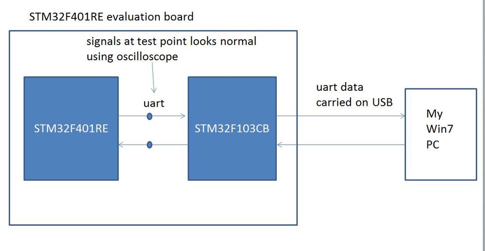

A newcomer in this product, I've been trying to do this for several days now..I'm using STM32F401RE evaluation board, and running the uart_printf example project that came with STM32cubeF4 package. The example project uses HAL driver, not StdPeriphLib drivers. I added a include path to avoid build error.When I repeatedly do printf(''CGCG'') with 0.5 interval, I can see the UART signal going from the MCU(STM32F401RE) to the MCU for USB connection(STM32F103CB) correctly. But I cannot see the data on my win7 PC uart terminal (9600, 8bit, odd, 1 stop, no flow con). When I press key 'C' or 'G' or any character in my PC terminal, it appears in the UART signal in reverse direction. That is, the UART signals between F401RE and F103CB looks normal. I can see STM32F401RE chip's USART2 DR register changing according to the key I press. My question is how can I check STM32F103CB chip's UART controller registers? Is there any way I can do that with uVision5? Can my board be broken?2015-12-04 6:08 AM
This seems like a duplicate of your other thread on materially the same topic.
Can my board be broken? I'm doubtful, but it's why buying at least two boards always makes sense, most of the postage costs accrue for the first device, and the subsequent parts contribute fractionally. No, the debugger cannot access the device doing the SWD/JTAG work. Odd parity? Make sure the STM32 is configured in 9-bit mode to account for the parity bit, and 8 data bits. Attached is an example .HEX, download it with the ST-LINK Utilities. 115200 8N1 Outputs to the USART, and echos back. ________________ Attachments : USART2NUCLEO401.hex : https://st--c.eu10.content.force.com/sfc/dist/version/download/?oid=00Db0000000YtG6&ids=0680X000006Hza0&d=%2Fa%2F0X0000000bNt%2FY5mFnm8Sx9jbHm0OnWLO0gL9PUkwseAinvhTCM9tK9s&asPdf=false2015-12-04 7:00 AM

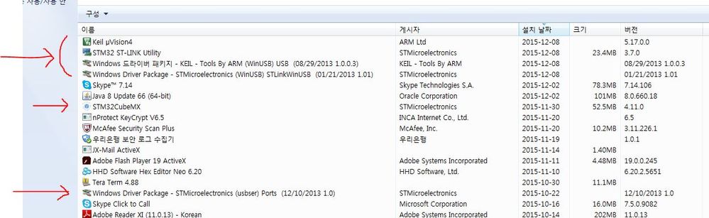

I've seen the USAR2UNCLEO401.hex program run ok in my PC, but after removing a driver I cannot reproduce it. I tried re-installing the programs, updated the board's firmware but cannot progress further.
Here is the driver install state of my PC.2015-12-08 6:43 AM
The is working for me
Win7 x64 V2.J24.M11 (from ST-LINK Utilities 3.7.0) ST-LINK 12/10/2013 1.1.0.0 STLink Virtual COM Port 12/10/2013 1.0.0.02015-12-08 5:08 PM
Win7 x64
the same with me, but when I add the latest VCP (latest is V1.4.0-10/20/2014, not your version is V1.0.0.0 2/10/2013) I cannot find COM port.I wish to try VCP V1.0.0.0. Do you have the install file for it yet? (for V1.4.0 it is stsw-stm32102.zip)2015-12-15 8:27 PM
Hi, clive1,
I tried the same project on my colleague's win7 computer, it first worked (can see print on serial port window). With the same program programed on the board, I tested it on my win7 machine but didn't work. I connected the board on my linux machine and it works! So it's not the problem of any program on the evaluation board but the driver problem on win7 machine as I suspected. I then tested the board on my colleague's computer but it doesn't work now. Looks like something changed after the first execution..We’re moving the ST Community to a new platform to give you a better and more reliable community experience.
