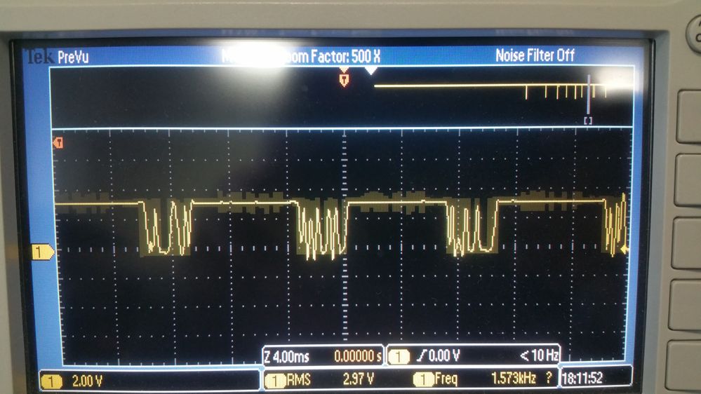

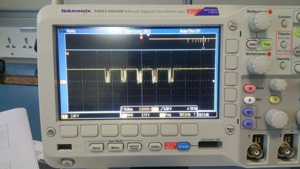

I am also attaching the UART RX signals captured on my Tektronix 200MHz DSO just for reference:

Hope it is just the scaling on the scope, but the signals look awful.
