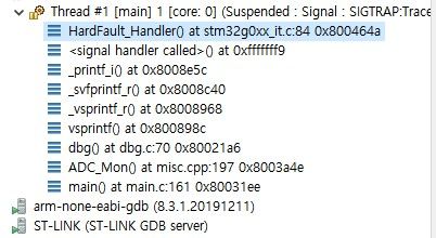

This is Hardfault at this case.
My tx function is as follow.
while (!(USART1->ISR & UART_FLAG_TXE));
USART1->TDR = (ch & 0x1FF);
I run IWDG and I found the watchdog expire at while loop at checking UART_FLAG_TXE
I was considered using DMA but I have to count some event in ADC interrupt.
If not using UART, no hardfault.
