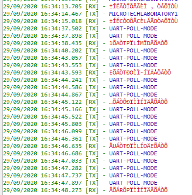

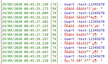

hi i'm trying to use the stm32H750 uart with Interrupt i managed to get it working but the message is a bit off ( alot ) here is a bit of the code
uint8_t tx_buff[]=" ";
uint8_t rx_buff[20]; HAL_UART_Receive_IT(&huart1, &rx_buff[0], 20);void HAL_UART_RxCpltCallback(UART_HandleTypeDef *huart){
n3=n3+5;
HAL_UART_Receive_IT(huart, &rx_buff[0], 20);
check = rx_buff[0];
if (check==67){
n1=n1+100;
HAL_UART_Transmit_IT(&huart1, rx_buff, 21);
}what i'm doing to try it , is that i'm monitoring via stmstudio and whenever a message arrive i'll rederect to the the host and read it again
here are the results
rx is coming back from mcu

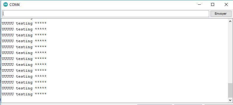

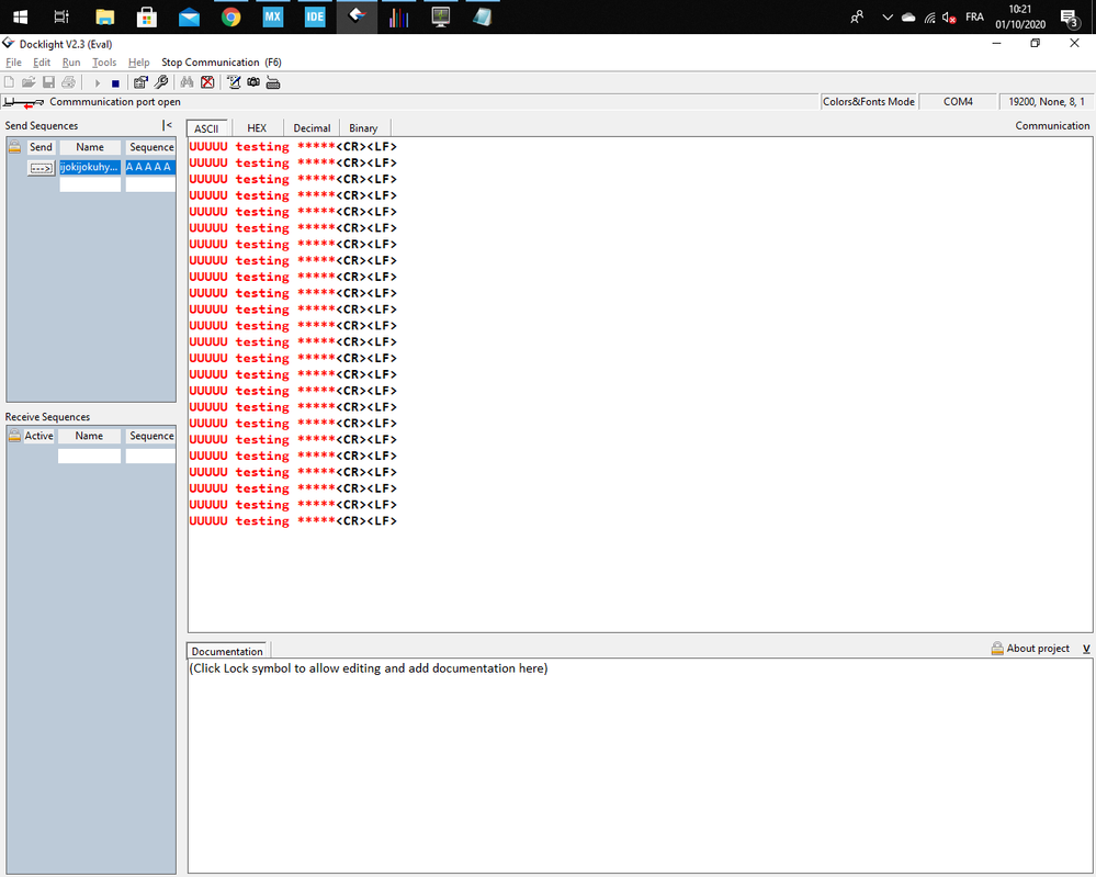

Prove that the output works, if that doesn't function there is no hope for reception.
while (1)
char str[] = "UUUUU testing *****\r\n";
HAL_UART_Transmit(&huart1, str, sizeof(str)-1, HAL_MAX_DELAY);
HAL_Delay(500);
I suspect the UART connectivity is broken, but would need to understand schematic/connectivity you have wired.

2020-10-01 4:01 AM
RCC_OscInitStruct.HSICalibrationValue = RCC_HSICALIBRATION_DEFAULT;what should i change it to

works too with arduino serial
