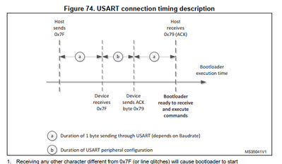

On page 279, there is the "Bootloader Startup timing" and on page 282, there is the "USART connection timing".
In table 122, you can see the USART bootloader minimum timing
It's no specify to be for a communication at 115200 bauds but I deduce it from the time of 1 USART byte.
I agree, there is any guarantee on the timing but I based my timeout for the response on the value of this table. I can increase this delay (and I do will do it).
The AN3155 describes only the USART protocol used by the STM32 bootlader without any timing diagram.
