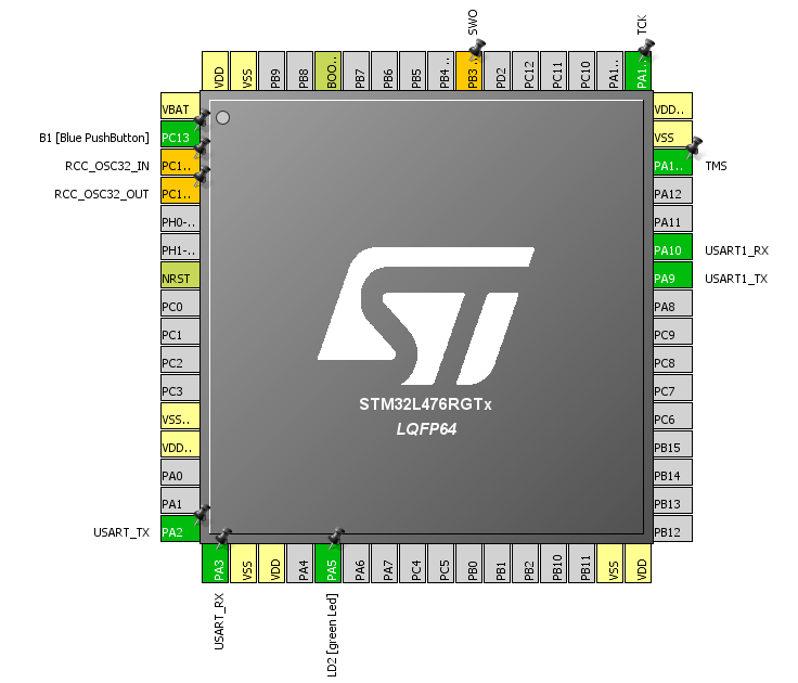

I use the Nucleo-L476RG to send and read data by the UART, so for that I used STM32CubeMx,
the goal is to send data in a Maximum of baudrate which is 10Mb/s as shown on the picture below, but the code is excuted only if the baudrate is less than 1Mb/s, otherwise I don't recieve any information in RX,

2018-04-06 6:44 AM
It is a simple way, just I used the USART1 (TX and RX pins), without interrupts, polling, DMA...
The configuration in the picture below can help you, hope!
