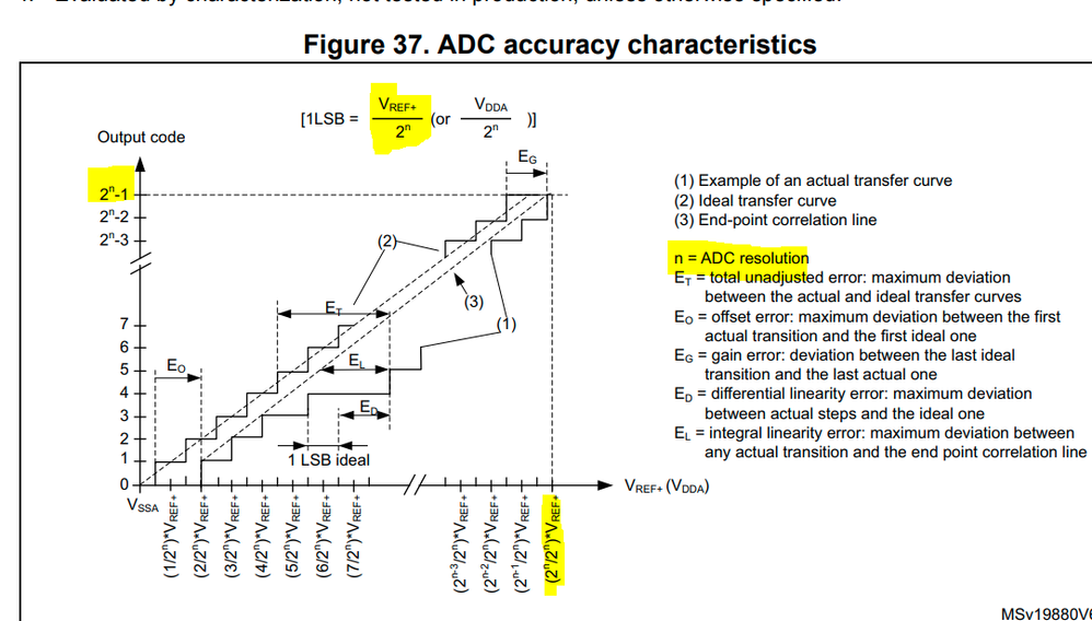

2022-04-14 6:06 AM
ad: "4095" vs "4096":
STM32F030x reference manual, page 205
VCHANNELx = VDDA / FULL_SCALE * ADC_DATAx
FULL_SCALE = 4095
and now what's right ... ?
2022-04-14 6:13 AM
It should be 4096, however that's well within the noise in this example.
My guess is your VREF+ is not 3.3V or you haven't calibrated it after startup.
