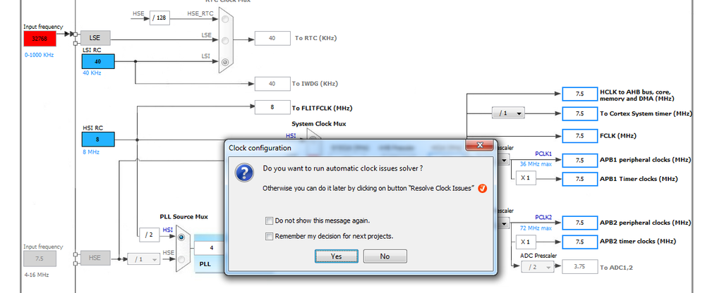

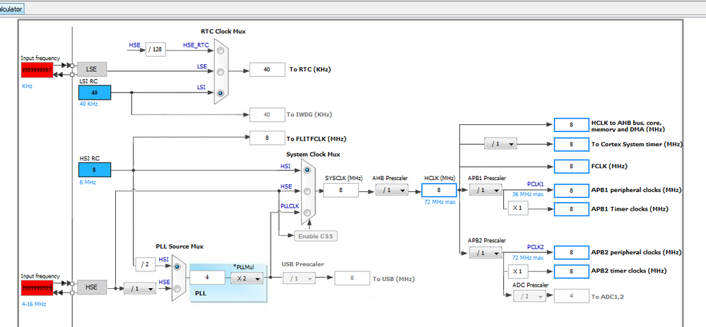

Just started to use the subj software combination and can't create a STM32F103C8 project in Cube because when I select a Crystal for HSE & LSE I get a red cross on the Clock Configuration tab and it is not possible to set a correct frequency in both fields.
I've seen similar complaints on this forum and looks like this issue still not fixed.

Some additional info:
- the SW is installed on Windows 7 64bit OS
- the regional settings change has no effect (''.'' or '','' separators)
- other MCU types are affected too
- the issue is related to the LSE clock source selector only - if only the HSE is set to ''Crystal/Ceramic Resonator'' the frequency can be altered normally.

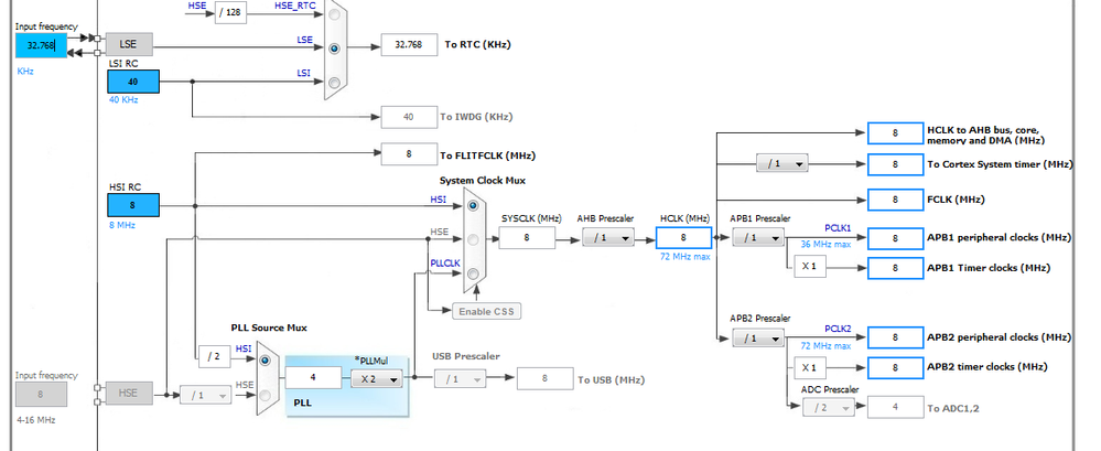

- if the LSE is set to ''Bypass'':
But when the ''Resolve...'' button is pressed or the value is changed manually it becomes normal.

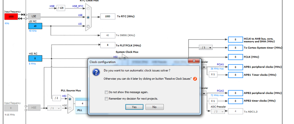

- then, when LSE is changed to ''Crystal/Ceramic Resonator'':

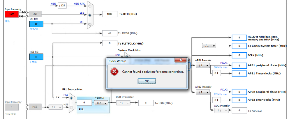

- when the ''Resolve...''button is pressed:

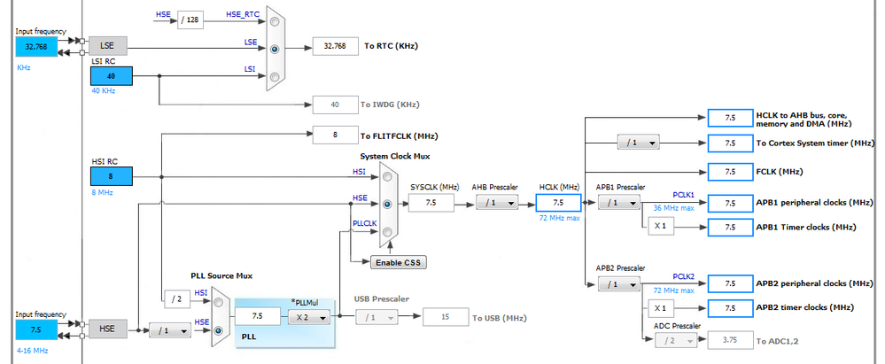

- when the ''Reset Clock configuration''button is pressed:
and now.... when the HSE is set to ''Crystal/Ceramic Resonator'' it seems to be working even if the Cube and the TrueSTUDIO were closed and restarted <8-O
