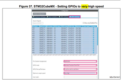

Please make sure that all GPIOs configured to very-high speed.

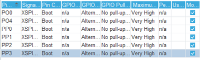

Hi Kaouthar,
The GPIOs are already configured to Very High speed by default. As for the refresh rate, I have tried several values. Currently, the XSPI clock is running at 50 MHz with a prescaler of 1 (so the PSRAM sees 25 MHz), and I am using a refresh value of 200.
