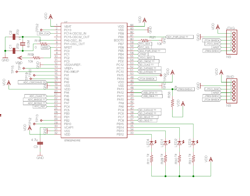

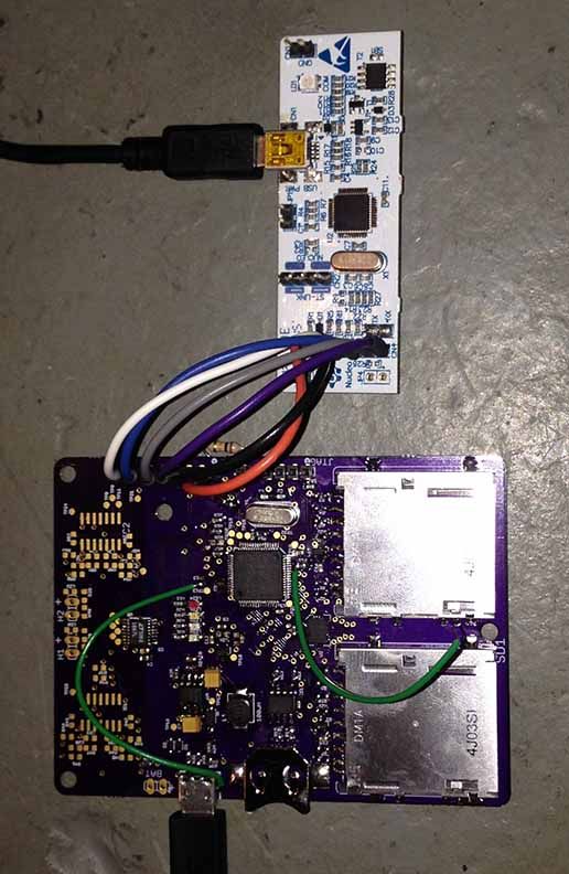

I designed a new board with the same chip (STM32F401RE) and I bought a second NUCLEO board to harvest the STLINK from. I cannot communicate with the new pcb at all -- from either STLINK, and I'm afraid I might have done something wrong in my schematic. I am attaching the schematic and a picture of my programming setup. Some notes: 1. I have removed the CN4 jumpers on the STLINK board2. I have tried with only SWDIO, SCK, GND, and VDD (also trying with SWO and NRST)3. I have tried various configurations of BOOT0, BOOT1, although by default BOOT0 = GND. 4. I have tested continuity all the way between the pins and the STLINK and made the wires shorter. No matter what I do, when I plug in the STLINK board, the NUCLEO drive contains a file called fail.txt, which contains the text ''SWD ERROR''. And I am unable to connect or communicate with the target board from the STLINK software.2015-07-23 5:19 PM

Check the voltage on the VCAP pin, and the NRST pin. Can you use the ST-LINK Utilities rather than the on-board mass-storage method? The board looks to have it's own supply, if so *don't* connect VDD to the ST-LINK2015-07-24 6:54 AM
The functional connections to the SWD are incorrect. E.g., GND is pin 3. Check Section 5.2.4 in the Nucleo reference manual.

After connecting VREF+ to VDD the chip powered up successfully.
I was looking for VDDA on your design, assuming that's the VREF+. The Power-On-Reset circuit and PLL are run off the analogue supply. The parts won't start without it.Pin 13 on the 64-pin devices is VDDA, +VREF is connected to it internally.We’re moving the ST Community to a new platform to give you a better and more reliable community experience.
