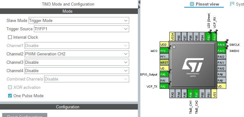

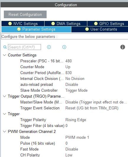

I set it up in CubeMX as timer 3, trigger mode, as show in pic:
I picked 830 to be compatible with 60Hz; this has the impact of a minimum power for 50Hz, but you know... problems for another day...

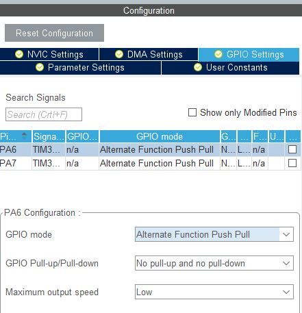

But when I connected it to my SCR circuit (verified by the oscilloscope to be generating a zero crossing pulse via open drain and 4k7 pullup), it does not work. The reason seems to be that the trigger input is actually configured as output ?!?! and therefore one pin is fighting the other. If I connect the GPIOA-0 via a 75ohm resistor, it no longer works.
The GPIO settings on CubeMX confirm this: but there is no way I can see of fixing this. ?!?!?!? So it works, but only if I make the signal strong enough to fight the push pull on the pin?????

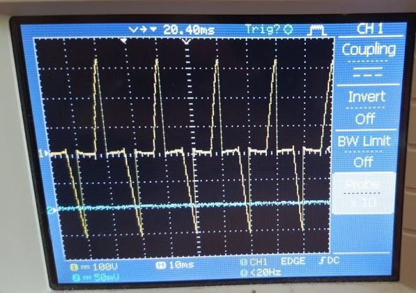

Photo below of it pushing 60% duty cycle into a lightbulb (as a test, getting built into bigger, more complex things later).
