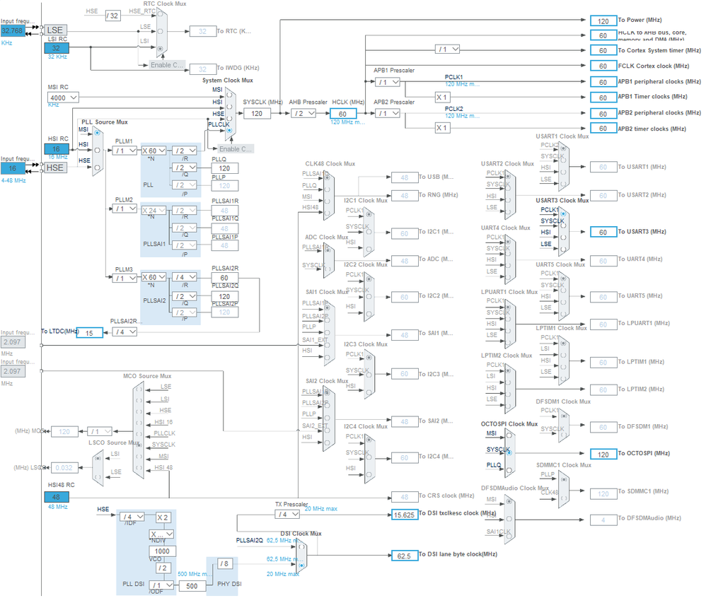

Thank you for your answer MM!
Below this is my clock configuration (using the IDE generator)
Let me know if you need me to display the related code generated.
