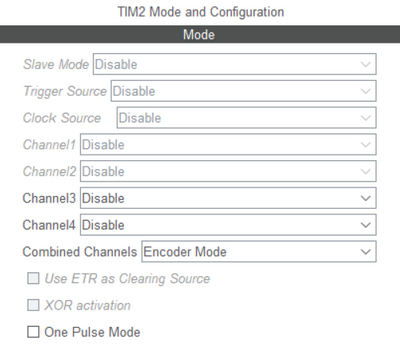

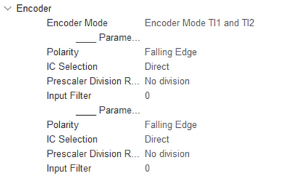

CubeMX setup: Clock Tree set to have a max frequency of 48MHz using the internal clock. PA1 and PA2 are set to have Pull-Up Resistors, TIM2 is set to Combined Channels = Encoder Mode. All the TIM2 parameters are left at default except for Encoder Mode = Encoder Mode TI1 and TI2, Polarity of both are set to Falling Edge. I have also activated the TIM2 global interrupt.

2023-07-01 9:38 AM
> I have checked with a logic analyzer and the encoder is clean, no glitches or anything like that on the transitions
What logic analyzer, more precisely, what was the sampling rate?
Bouncing on encoders with mechanical contacts can have surprisingly high frequencies, and if you run the timer at tens of megahertzs it is perfectly capable of capturing pulses below 100ns. That's most likely could explain all the symptoms you've described above.
Generally, it's a bad idea to base any processing of timer in encoder mode on interrupts (e.g. an often seen method to solve counter rollovers is to use the Update interrupt, and that similarly can fail because of either bounces or the timer stopping at the rollover point, vibrating somewhat, generating a series of pulses faster than the ISR can handle).
IMO the best method to handle the TIMx in encoder mode is to read out TIMx_CNT often enough so that counter rollovers are properly resolved (i.e. successive readouts have to occur no further than half of revolution at the highest possible speed). One way to achieve this is to sample TIMx_CNT from interrupt or DMA of a different timer; but for manually turned encoders, usually sampling them in the superloop (if your firmware design is of that kind) usually suffices.
Some users use hardware filters on A and B signals (simple RC filters), and they may be a good idea, but generally I'd still recommend not to rely on those and maintain what I've written above.

Thank you for your quick response, I this is exactly how I managed to get it working. I disabled the global interrupt and simply put this read in my "superloop":
counter = TIM2->CNT;
This has completely resolved my problem. The only reason I was trying to do it in an interrupt is that I was always taught that you should do as much as possible in either function calls or interrupts for both "best practices" as well as best efficiency.
