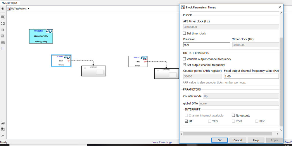

Hi0690X000006Cv6xQAC.png,
Although I used the right configuration, i have the same issue with TIM1 & TIM6 (refer to the attached figure). Did you find a solution ?
Best regards
