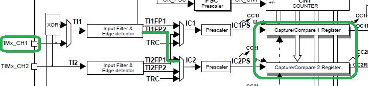

2015-11-23 9:55 AM
Grief this is such a muddle.
Ok, if you are programming the counter with 1 MHz ticks, it's NOT going to be ticking at the HCLK rate. You'd divide the ticks into 1000000 to get frequency, right? You seem to have pulled a bunch of different code in, an end up configuring CH4 which doesn't support PWM Input./**************************************************************************************/

2015-11-23 9:57 AM
19999 1499
50.002500 Hz, Duty 7.495375 % 19999 149950.002500 Hz, Duty 7.495375 % 19999 149950.002500 Hz, Duty 7.495375 %2015-11-23 10:02 AM
Using the full precision of the timer...

2015-12-08 7:10 AM
I'm not an advocate for the Cube tools, you'll need to dig through that yourself.
The Indirect mode basically allows the routing of the filtered/edged CH1 (TI1) signal into CH2/CCR2, and separately TI2 into CH1/CCR1. CH3/4 also pair, but not in PWM Input mode. Look at the block diagram from the TIM as it relates to the input conditioning, and routing between the CH1/2 and CH3/4 pairs. What PWM Input mode does is assign one channel latch to each edge, and resets at the period. So typically one latch holds the ticks for the entire period, ie rising-to-rising edges, while the second latch holds the tick for the mark duty, ie rising-to-falling edges. It's particularly useful for high frequencies, where you don't want to have heavy interrupt loading, and can just read the latch periodically. The resetting is a pain, as is the need to use either CH1/CH2 as an input, because it effectively soaks up a timer per signal.We’re moving the ST Community to a new platform to give you a better and more reliable community experience.
