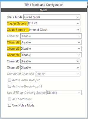

Thank you for asking. TIM1 is set with this MX configuration:

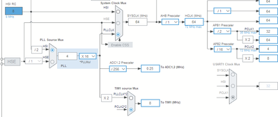

TIM1 runs on this portion of the clock tree:
so it uses HSI -> SYSCLK -> HCLK -> PCLK2*2 for an eventual clock input of 8 MHz. I will check the prescaler later, though I know that prior to STOP it is at the correct value.
